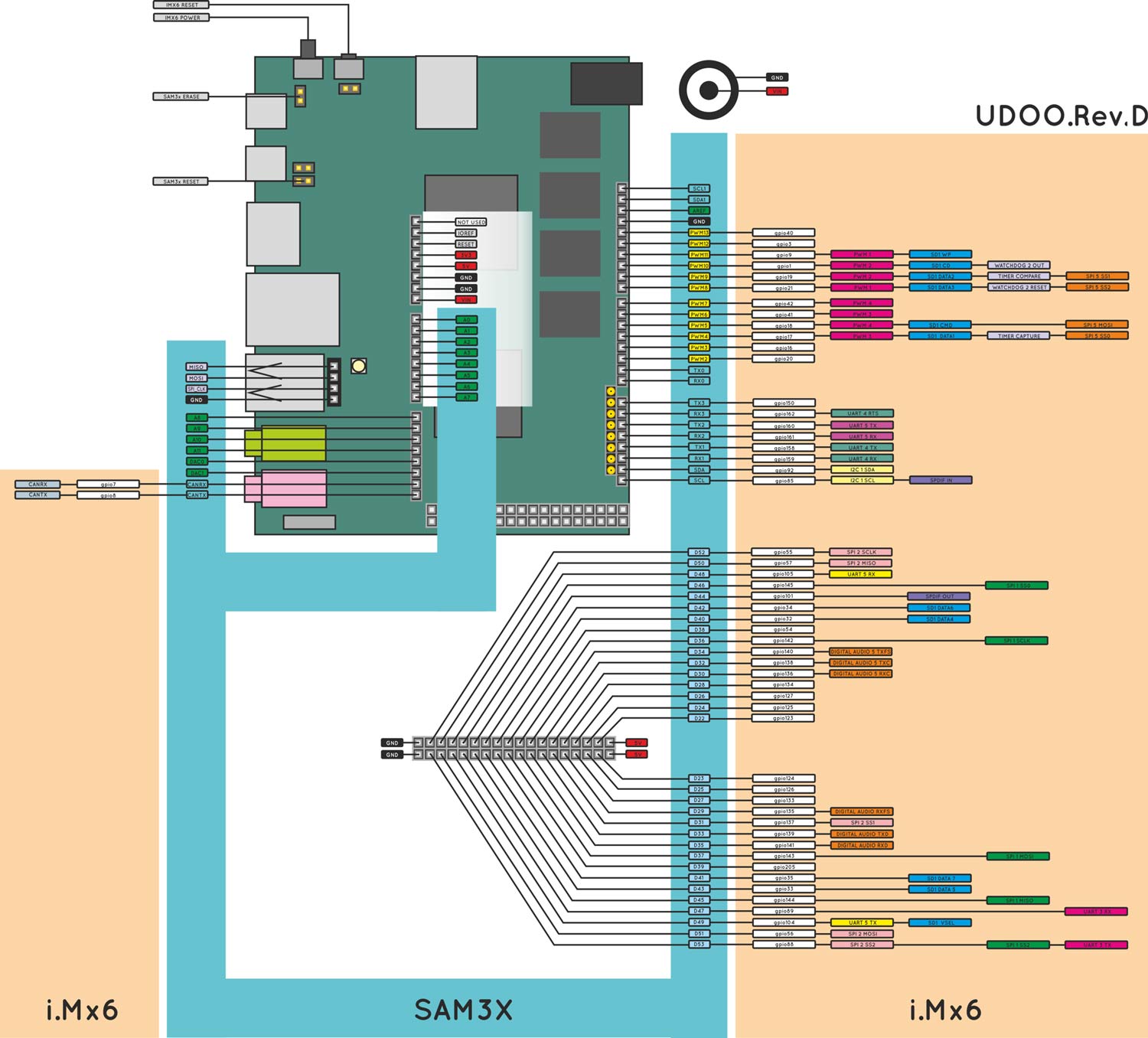

    I wrote some patches to enable SPI and CAN for the UDOO Quad. Here the is the SPI patch and here the CAN bus patch.
    I didn't try them directly but I looked at the kernel logs to see if everything is fine. Unfortunately, there is errors with the pinmux.
    There is no mention of pin 114 and pin 64 on the UDOO Quad pinout.
    PS: maybe it could be smarted to write custom .dts files with include to override UDOO kernel .dts like imx6dl-udoo-lvds7.dts do for LCD drivers support for example.
